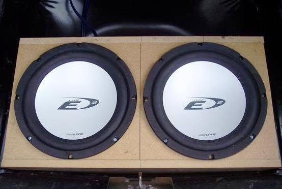

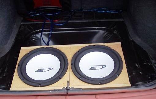

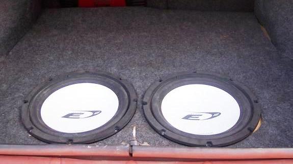

saturnsubohio:
found someone on cardomain who had done what I am looking but I want mine to drop lower (want to hide them under the carpet, going for a no show install). Looks like it’s just a basic build. I guess my question should have been initially:
Does anyone know of a good pair of shallow mount subs?
I am not opposed to doing 10’s.
Here’s picks off cardomain:
Box building and choosing subs -- posted image.
