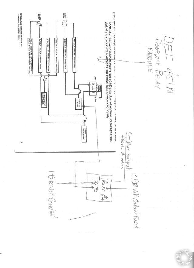

Okay, I have done a little research and I think I have come up with the right way to wire in priority locking and it would be great if someone could give me a yah or nah and if a nah a little help would be greatly appreciated.  Here is a diagrahm of what I think I need to do.  From what I can tell my truck sends a positve to lock the doors a negative to unlock drivers door but a positive for 2nd unlock.  The clifford 590.2x alarm has 2 negative door lock outputs so I am using a DEI 451m doorlock relay module.
window module wiring, 98 chevy crew cab - Page 2 -- posted image.
Also I have a couple of other quick questions.  Is it recommended to install a diode when tapping into a (+) 12 volts constant to power a module, relay or other device.  For example I tapped into the the constant 12 volts at the headlight switch to power a relay for domelight supervision and will probably do the same for the tilt sensor.  I am mounting the tilt sensor on a flat level spot behind the dash bezel.  And, what about installing a diode for a (-) door trigger when the same wire is being used for the domelight supervision.
Thank you

t&t tech
Platinum - Posts: 2,622
Joined: October 05, 2008
Location: Trinidad and Tobago
Posted: April 05, 2010 at 3:59 PM / IP Logged
If  using the door trigger wire as the dome trigger as well, a diode normlly isn't necessary (know i never used one), also no diode at the 12volts supply for the relay, however i would reccomend connecting it to a better source like say the ignition harness, is it possible to have two different signals controlling the door locking system?, i've never seen that before, i won't reply to that unless someone else confirms this!
hawks
Member - Posts: 41
Joined: November 30, 2009
Posted: April 06, 2010 at 1:27 AM / IP Logged
