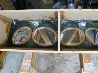

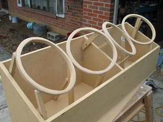

1-29-05 this weekend it was a little warmer we removed the bottom and layed 3 layers of glass inside.
more pics! -- posted image.

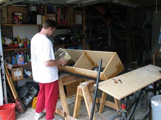

1-29-05 yes it was warmer but we had to help it a little....I put my son on heater duty!
1-29-05 it only took about an hour to set up then we flipped and started to prep the outside for glass.....that fun starts tomorrow.
if all gose right and murphy doesn't come around, I think we can start the bondo! yippie!
it's pretty strong with just the three interior layers....6 total should be real strong...or should i add more?

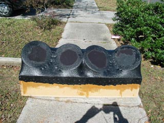

he wants the outside covered with suede, so a couple of skim coats of bondo should be enough to give it a smooth finish for that.

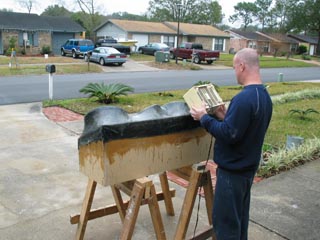

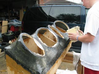

1-30-05 after the three layers were applied this morning we helped it dry somemore.

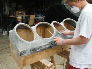

1-30-05 I even got in the act!

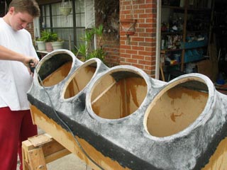

1-30-05 after about an hour we started to sand it down.

the box dosent flex at all with the six lyaers on it. each sub will get about 185wrms, I'm hoping that it will hold up to that pressure, any thoughts?

how thick can the bondo be and still be effective, there is a 1/8 to a 1/4 inch gap where the sub sits. it's only on one side, i was planning on building it up so the subs sit flush and gets a compleete seal.

If you have to build up a section I for the sub to mount too, I would build it out of fiberglass. Or you should be able to take the fiberglass dust if you can get enough out of the box or something mix it w/ resin and it will become like a putty and you build up w/ that.  If you dont have enough dust you can add talc powder to it and do the same thing.
